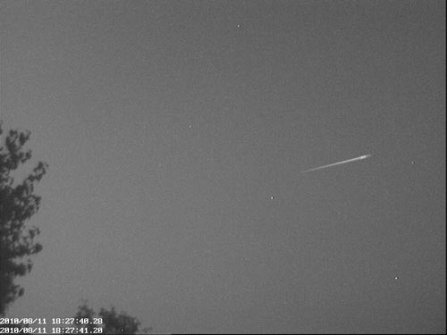

Дымарь раздуло, и попёрли Персеиды. За 0,5 часа наблюдений 3 штуки.
18:27:40 Meteor #1 at (0.702,0.495)->(0.828,0.536) frames=14 dur=0.54s pixel=9 dir= 18Ь vel=13.7Ь/s Е=3.5
         shower=PER bright=0.7mag raddist=2.3Ь exp vel=15.0Ь/s (23.278h,39.20Ь)-> (22.795h,33.08Ь) acc=3.3'
18:55:19 Meteor #2 at (0.287,0.108)->(0.293,0.096) frames=4 dur=0.18s pixel=4 dir=295Ь vel=4.3Ь/s Е=2.1
         shower=PER bright=1.5mag raddist=1.1Ь exp vel=3.5Ь/s (2.652h,42.70Ь) -> (2.645h,42.01Ь) acc=1.8'
18:55:19 Meteor #3 at (0.308,0.072)->(0.315,0.064) frames=4 dur=0.14s pixel=10 dir=311Ь vel=5.0Ь/s Е=4.2
         shower=PER bright=-0.4mag raddist=3.9Ь exp vel=3.8Ь/s (2.612h,40.56Ь) -> (2.592h,40.00Ь) acc=0.8'
Второй и третий, похоже, один. Пока не могу проверить визуально.

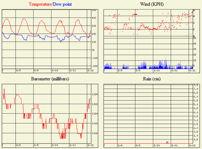

Атмосферное давление за ночь увеличилось на ~8гПа и долгожданный С-З ветер...

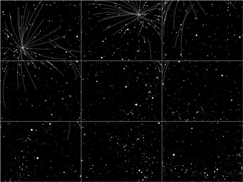

Результаты видеонаблюдений за период 30 июля - 5 августа 2010 г.:
Observing conditions:
Date            mean F           mean vLm
2010.07.30        1.2               4.4
2010.07.31        1.1               4.7
2010.08.01        1.0               4.8
2010.08.03        1.2               4.9
2010.08.04        1.0               4.8
2010.08.05        1.0               5.2
Results:
Date       Teff,h                    Meteors
2010.07.30  2.80    12 (CAP 1, SDA 1, PER 1, SPO 9)
2010.07.31  2.44    15 (PER 7, SPO 8 )
2010.08.01  4.44    37 (ANT 2, CAP 1, SDA 4, PER 16, SPO 14)
2010.08.03  1.33    14 (SDA 1, PER 4, SPO 9)
2010.08.04  4.67    58 (ANT 2, CAP 2, SDA 5, KCG 5, PER 21, SPO 23)
2010.08.05  5.15    83 (ANT 1, CAP 2, SDA 9, KCG 2, PER 37, SPO 32)
Total      20.83   218 (ANT 5, CAP 6, SDA 19, KCG 7, PER 86, SPO 95)
These meteors on Youtube:
20100730 20100805
Remarkable events:
- 31 July 19:59 UT. Bright PER meteor (D=0.48 sec, m=-2.0, 1.80 sec
train);
- 05 August 17:04 UT. Bright PER meteor (D=0.76 sec, m=-2.0, 2.00 sec
train);
- 05 August 19:11 UT. Bright PER meteor (D=1.76 sec, m=-5.0, 10.00 sec
train);
- 05 August 20:12 UT. Two simultaneous meteors (3.5 mag SPO and 4.0
mag SDA);
20100730 20100805 i
Magnitude distributions:
2010.07.30
|Shower| -5 | -4 | -3 | -2 | -1 |. 0 | +1 | +2 | +3 | +4 | +5 |
| CAP..|....|....|....|....|....|....| 1.0|....|....|....|....|
| SDA..|....|....|....|....|....|....|....|....|....| 1.0|....|
| PER..|....|....|....|....|....|....|....|....| 1.0|....|....|
| SPO..|....|....|....|....|....|....| 1.0| 2.0| 2.0| 4.0|....|
2010.07.31
| SDA..|....|....|....|....|....|....|....|....| 1.5| 0.5|....|
| PER..|....|....|....| 1.0| 0.5| 1.5| 1.0| 1.0| 1.0| 1.0|....|
| SPO..|....|....|....|....|....|....| 1.0| 3.0| 0.5| 3.0| 0.5|
2010.08.01
| ANT..|....|....|....|....|....|....|....|....| 1.5| 0.5|....|
| SDA..|....|....|....|....|....| 1.0|....|....| 0.5| 1.5| 1.0|
| PER..|....|....|....|....|....|....|....| 3.0| 8.0| 4.5| 0.5|
| SPO..|....|....|....| 0.5| 0.5| 0.5| 0.5| 0.5| 4.0| 6.0| 0.5|
2010.08.03
| SDA..|....|....|....|....|....|....|....|....| 1.0|....|....|
| PER..|....|....|....| 0.5| 0.5|....| 0.5| 1.0| 1.0| 0.5|....|
| SPO..|....|....|....|....|....| 0.5| 1.0| 0.5| 2.5| 4.0| 0.5|
2010.08.04
| ANT..|....|....|....|....|....|....|....|....| 1.0| 1.0|....|
| CAP..|....|....|....|....|....|....|....| 1.0| 1.0|....|....|
| SDA..|....|....|....|....|....|....| 1.0| 0.5| 2.0| 1.5|....|
| KCG..|....|....|....|....|....|....| 1.5| 0.5| 1.0| 2.0|....|
| PER..|....|....|....|....| 1.5| 1.0| 1.0| 3.5| 5.5| 8.5| 0.5|
| SPO..|....|....|....|....|....|....| 1.0| 5.5| 8.0| 8.0| 0.5|
2010.08.05
| ANT..|....|....|....|....|....|....|....|....|....| 0.5| 0.5|
| CAP..|....|....|....|....|....|....|....|....| 1.5| 0.5|....|
| SDA..|....|....|....|....|....|....|....| 1.0| 2.0| 6.0|....|
| KCG..|....|....|....|....|....|....|....| 1.0|....| 1.0|....|
| PER..| 1.0|....|....|....| 1.0| 0.5| 0.5| 6.0|12.5|15.0| 1.0|
| SPO..|....|....|....|....| 0.5| 2.0| 1.5| 3.5|12.0|10.5| 2.0|

Кстати, feraj, а в какую сторону ваша камера была направлена? Просто у меня вот такой результат https://astronomy.ru/forum/index.php/topic,76387.new.html#new А у вас как? Я пока астрометрию не делал (кстати, а в каком софте вы делаете астрометрию?).
Моя камера направлена почти в зенит (немного наклонена на юго-восток, там небо темнее). В ночь максимума у меня было в основном пасмурно, только отдельные небольшие окна, поэтому там будет не густо в любом случае. Результат пока не могу сказать даже примерно, поскольку эта ночь ещё не проанализирована (сегодня ей займусь).
Их характеристик метеора я сейчас определяю только яркость и принадлежность к потоку (более подробные характеристики нахожу только для "выдающихся" метеоров). Специального софта не использую. Яркость определяю "на глаз", сравнивая с соседними звездами и делая поправку в +1.0 зв на ИК составляющую. Принадлежность к потоку определяю с помощью наложения рисунка с треком метеора на звёздное небо в планетарии Starcalc с плагином meteors. Получается весьма наглядно и точно.
