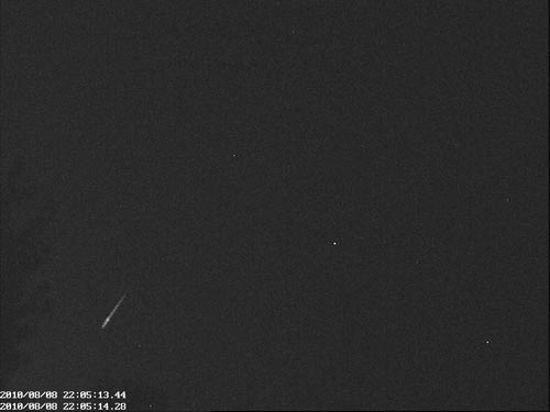

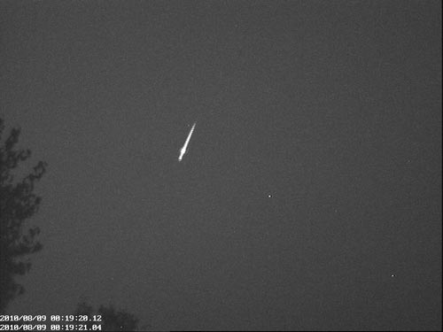

2010-08-08
Не подумайте, что белые точки это звезды, lmag=0m. :)
22:05:13 Meteor #1 at (0.221,0.273)->(0.186,0.210) frames=11 dur=0.46s pixel=8 dir=241Ь vel=7.5Ь/s Е=3.5
         shower=PER bright=0.8mag raddist=0.1Ь exp vel=7.2Ь/s (5.678h,51.59Ь) -> (6.016h,49.53Ь) acc=4.3'
00:19:20 Meteor #2 at (0.439,0.627)->(0.405,0.516) frames=14 dur=0.54s pixel=32 dir=252Ь vel=8.7Ь/s Е=7.4
         shower=PER bright=-0.7mag raddist=1.5Ь exp vel=10.1Ь/s (5.408h,56.77Ь) -> (6.069h,54.90Ь) acc=3.8'
Observing Statistics
start of observation     : 2010/08/08 18:16:13
end of observation       : 2010/08/09 00:48:00
effective observing time : 6 h 32 m 33 s
# active meteor showers  : 6
# observed meteor showers: 1
# observed meteors       : 2
Perseids (PER)           : Д=2, М=0.1 mag
Antihelion (ANT)         : Д=0
alpha-Capricornids (CAP) : Д=0
kappa-Cygnids (KCG)      : Д=0
Piscis-Austrinids (PAU)  : Д=0
S-delta-Aquarids (SDA)   : Д=0
Sporadics (SPO)          : Д=0
