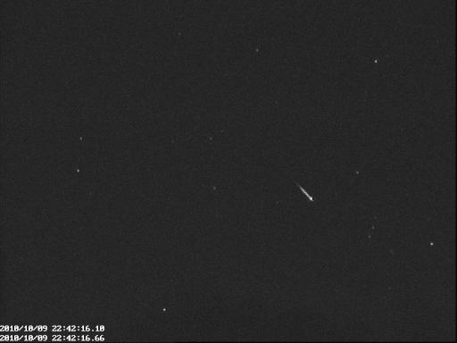

Камера переехала в новый кожух с четырьмя грелками, карлсоном и термостатом.
Для владельцев 1/3", могу порекомендовать объектив: Pentax TS3V310ED.
22:42:16 Meteor #8 at (0.656,0.457)->(0.677,0.428) frames=5 dur=0.18s pixel=11 dir=305Ь vel=12.3Ь/s Е=4.9
         shower=DAU bright=0.4mag raddist=2.1Ь exp vel=11.1Ь/s (5.945h,9.88Ь) -> (5.927h,7.93Ь) acc=2.1'

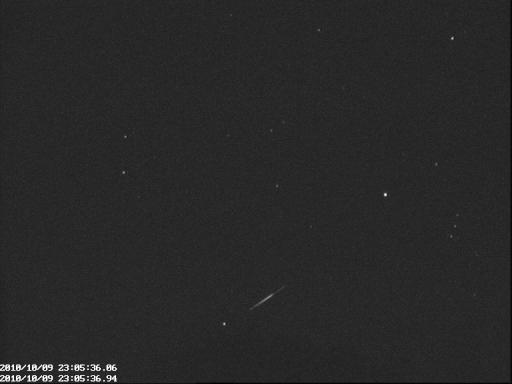

23:05:56 Meteor #10 at (0.925,0.935)->(0.948,0.973) frames=7 dur=0.26s pixel=8 dir= 59Ь vel=9.9Ь/s Е=3.4
         shower=ORI bright=1.3mag raddist=2.1Ь exp vel=9.4Ь/s (4.405h,15.94Ь) -> (4.241h,16.13Ь) acc=1.7'
Observing Statistics
start of observation     : 2010/10/09 16:55:50
end of observation       : 2010/10/10 03:01:00
effective observing time : 10 h 5 m 42 s
effective collection area: 13200.1 km^2 * hour / r^(6.5-lm)
# active meteor showers  : 5
# observed meteor showers: 4
# observed meteors       : 25
Sporadics (SPO)          : Д=17, М=1.4 mag
delta-Aurigids (DAU)     : Д=4, М=1.4 mag
Orionids (ORI)           : Д=2, М=1.1 mag
N-Taurids (NTA)          : Д=1, М=1.1 mag
S-Taurids (STA)          : Д=1, М=1.6 mag
Draconids (GIA)          : Д=0
Date: 09.10.2010
  Time   #DS RLM #RS #IS LM   ECA
22:43:00 410 4.8 126  67 4.3 23.6
22:44:00 391 4.8 126  62 4.3 23.2
22:45:00 434 4.8 127  67 4.3 23.6
22:46:00 417 4.8 127  69 4.3 24.0
22:47:00 445 4.8 125  69 4.3 24.0
22:48:00 400 4.8 125  64 4.3 23.4
22:49:00 434 4.8 125  70 4.3 24.0
23:02:00 411 4.8 119  56 4.1 21.0
23:03:00 424 4.8 118  56 4.2 21.2
23:04:00 369 4.8 117  60 4.3 23.2
23:05:00 402 4.8 116  54 4.2 21.2
23:06:00 400 4.8 116  56 4.2 21.4
23:07:00 442 4.8 116  64 4.3 24.5
23:08:00 420 4.8 117  58 4.2 22.8

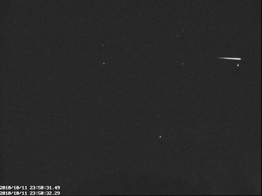

23:50:31 Meteor #7 at (0.840,0.706)->(0.917,0.700) frames=11 dur=0.46s pixel=18dir=356Ь vel=8.4Ь/s Е=8.5
         shower=SPO bright=0.2mag (6.077h,11.88Ь) -> (5.816h,8.30Ь) acc=4.1'

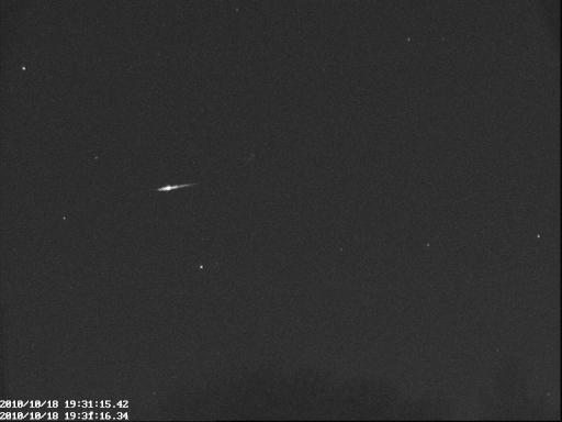

« Ответ #726 : 19 Окт 2010 [01:03:20] »
19:31:15 Meteor #3 at (0.334,0.562)->(0.285,0.552) frames=13 dur=0.54s pixel=22 dir=191Ь vel=5.9Ь/s Е=8.7
         shower=STA bright=0.2mag raddist=2.1Ь exp vel=5.1Ь/s (4.355h,25.55Ь) -> (4.580h,26.76Ь) acc=1.8'

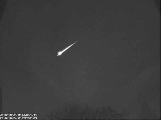

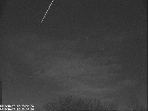

« Ответ #728 : 24 Окт 2010 [00:32:08] »
02:23:37 Meteor #5 at (0.359,0.999)->(0.277,0.795) frames=19 dur=0.74s pixel=13 dir=248Ь vel=16.9Ь/s Е=6.3
         shower=STA bright=0.7mag raddist=4.0Ь exp vel=12.9Ь/s (10.456h,42.37Ь) -> (11.321h,37.09Ь) acc=2.8'
01:22:51 Meteor #51 at (0.478,0.657)->(0.359,0.541) frames=14 dur=0.54s pixel=91 dir=224Ь vel=16.4Ь/s Е=11.2
         shower=ORI bright=-1.3mag raddist=0.2Ь exp vel=17.1Ь/s (9.810h,24.35Ь) -> (10.504h,23.94Ь) acc=3.5'

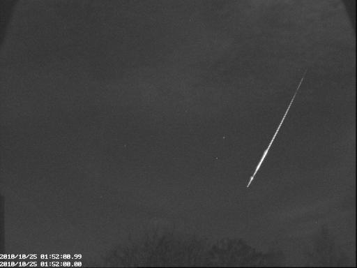

01:52:01 Meteor #24 at (0.856,0.730)->(0.702,0.324) frames=72 dur=2.98s pixel=24 dir=249Ь vel=9.1Ь/s Е=6.2
         shower=NTA bright=0.1mag raddist=2.7Ь exp vel=11.3Ь/s (8.845h,12.02Ь) -> (10.185h,2.90Ь) acc=2.2'
« Последнее редактирование: 25 Окт 2010 [08:47:53] от lazyBSD »
