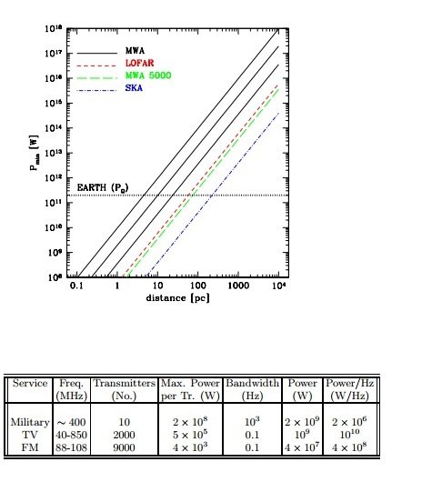

Вот эта особенно- про мощность земных радиосигналов и возможности обнаружить подобные нашими радиотелескопами
Eavesdropping on Radio Broadcasts from Galactic Civilizations with Upcoming
Observatories for Redshifted 21cm Radiation
Abraham Loeb & Matias Zaldarriaga
Astronomy Department, Harvard University, 60 Garden Street, Cambridge, MA 02138
http://arxiv.org/pdf/astro-ph/0610377v2.pdf
FIG. 1: The minimum detectable radio power Pmin for various
high-redshift 21 cm surveys and observing times as a function
of the distance to the source. We assume for simplicity that
the source emits isotropically and steadily. For the MWA we
adopt a bandwidth of ∆ν = 8 kHz and observing times of
1 hour, 1 day and one month (solid lines from top to bottom).
We assumed the same bandwidth for LOFAR, for a
future extension of MWA with ten times its collecting area
(called MWA 5000) and for the SKA. In those cases we only
plot the sensitivity for a one month integration. The dashed
line delineates the power per solid angle, PΩ, along the beam
of military radars [Ballistic Missile Early Warning Systems
(BMEWS)] from our civilization.
TABLE I: Characteristics of the largest components of radio
emission from the Earth (adopted from [12] and public web
sites on BMEWS). The power per solid angle PΩ along the
beam of military radars (BMEWS) is larger by two orders of
magnitude than the total power entry in the table.
_________________________________________________ ______________________________________
