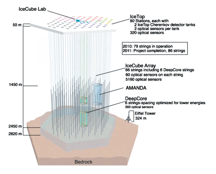

В IceCube, оказывается, полноценные кабели протянуты на километры внутри льда.
In order to detect the Cherenkov photons emitted by charged particles traversing the ice, 5160DOMs are deployed between 1450 m and 2450 m below the surface of the ice on 86 vertical strings.Each string consists of 60 DOMs deployed along a single cable containing twisted copper-wirepairs.
2.2.2 Cable Penetrator, Cable and Connector
A penetrator assembly brings three wire pairs out through a 16.3 mm hole in the DOM glass sphere.The wires are routed inside a customized cable, shown in figure 4, and terminate at a pressure-tight,waterproof connector that mates with a similar connector that continues each pair into the maincable. One wire pair carries power and a bidirectional digital communications stream, connect-ing ultimately with a computer in the IceCube Laboratory building (section 4). The other wireslead to neighboring DOMs directly above and below, carrying LC digital pulses that signify time-correlated hits in nearby DOMs (section 2.2.5).DOMs were produced in two versions, in which the communications wire pair was eitherelectrically terminated (140 Ω) or unterminated inside the DOM. The terminated DOM is deployed17 m below the unterminated one (7 m or 10 m in DeepCore strings) and therefore includes a cor-respondingly long penetrator assembly cable (figure 4).The entire penetrator assembly was designed and produced by SEACON Brantner & Asso-ciates (El Cajon, California). The part that seals against the DOM glass is a hollow steel bolt thatis secured inside the DOM by a nut and spring washer and compresses a fluorosilicone O-ringagainst the outside surface. The steel part includes additional sealing around the wires that passthrough it. Outside the DOM, a plastic shell is molded around the steel and onto the cable jacket.External mechanical features like the penetrator are subject to large stresses during deployment andthe refreezing process; a right-angle bend outside the DOM was included for robustness, based onprevious experience deploying AMANDA modules
Figure 4: (Left) DOM as deployed on main in-ice cable, showing cable breakout to the penetratorassembly and the mechanical support system. (Right) Schematic of cable connections for a set offour DOMs serviced by two wire pairs from the surface that carry power and communications. The“T” labels indicate where electrical termination (140 Ω) is installed in one of two DOMs that sharesuch a wire pair. Other wire pairs are used for bidirectional signaling between neighboring DOMs,in order to check for in-time coincident detections.
Источник.
До двух с половиной км (а там дальше вообще земля, поэтому дальше не бурили: Средняя толщина льда Восточной Антарктиды равняется 2,5 км, а максимальная — почти 4,8 км. Существенно меньшие размеры имеет Западно-антарктический ледяной щит: площадь менее 2 млн км², средняя толщина — лишь 1,1 км, поверхность не поднимается выше 2 км над уровнем моря. Фундамент этого щита на больших площадях погружён ниже уровня океана, его средняя глубина около 400 м. ).
Вроде бы стойкие. Но и лёд, надо учитывать, земной, тёплый)
http://www.youtube.com/watch?v=2l_01ELFeVE#
« Последнее редактирование: 12 Июн 2020 [00:25:27] от Metatr0n »
