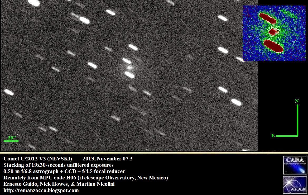

After posting on the Minor Planet Center's new PCCP webpage (cf. CBET 3682),
other CCD astrometrists have also commented on the object's cometary
appearance.  H. Sato (Tokyo, Japan; remotely with a 0.32-m f/8 astrograph
located near Nerpio, Spain; Nov. 7.1) finds a 1'.5 strongly condensed coma
with no obvious tail on eight stacked 30-s exposures.  E. Guido, N. Howes, and
M. Nicolini (remotely with an iTelescope 0.50-m f/6.8 astrograph near Mayhill,
NM, U.S.A.; eleven unfiltered 30-s images on Nov. 7.3) note a diffuse coma
about 18" in diameter, elongated toward p.a. 275 deg.  R. Ligustri (Udine,
Italy; remotely with a 0.25-m f/3.3 reflector near Mayhill; Nov. 7.4) finds a
very diffuse object with coma of diameter about 40".  M. Urbanik (Cadca,
Slovak Republic; remotely with a 0.25-m f/3.4 reflector near Mayhill; Nov. 7.4)
finds a condensed coma 50" in diameter.  Erik Bryssinck (Kruibeke, Belgium;
remotely with an iTelescope 0.43-m f/4.5 reflector near Mayhill; Nov. 7.40)
reports a central condensation with a relatively wide coma of size 87" x 57"
and a hint of a tail toward p.a. 281 degrees.  W. H. Ryan (Magdalena Ridge
Observatory, 2.4-m f/8.9 reflector; Nov. 7.43-7.46) finds a distinct, bright
coma and a wide tail in p.a. about 270 deg on R-band images.  G. Hug (Scranton,
KS, U.S.A.; 0.56-m reflector; Nov. 7.5) writes that the object is an obvious
comet, measuring a coma extension about 30" long toward p.a. about 285 deg.
